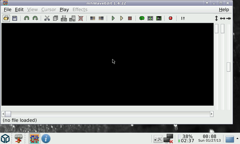

Just recompiled this utility.
It's an editor for sound files who can also record from the internal mic of the pandora.
I have tested with my Pandora and have recorded my voice correctly with it B)

Now some pandora shots:
Main of app:
shot of prefs on how to setup the mic:
