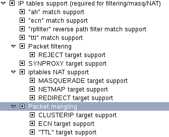

    Edit: Must have had a bad download...it was acting funky while downloading so I tried again and it loaded this time.
    Will I need to load this every time I use mangle?
    --- Double Post Merged, Apr 27, 2017, Original Post Date: Apr 27, 2017 ---
    Ok so it loads, but I get "No chain/target/match by that name" when attempting
    sudo iptables -t mangle -A POSTROUTING -j TTL --ttl-set 65
    Which works on my Pi and Debian 8 laptop. Kernel or plug in issue?

    The standard location of this module is inside /lib/modules/3.2.84/kernel/net/ipv4/netfilter/
    As for your second question, the module misses some options.

    There's a mangling sub-option for TTL target support.
