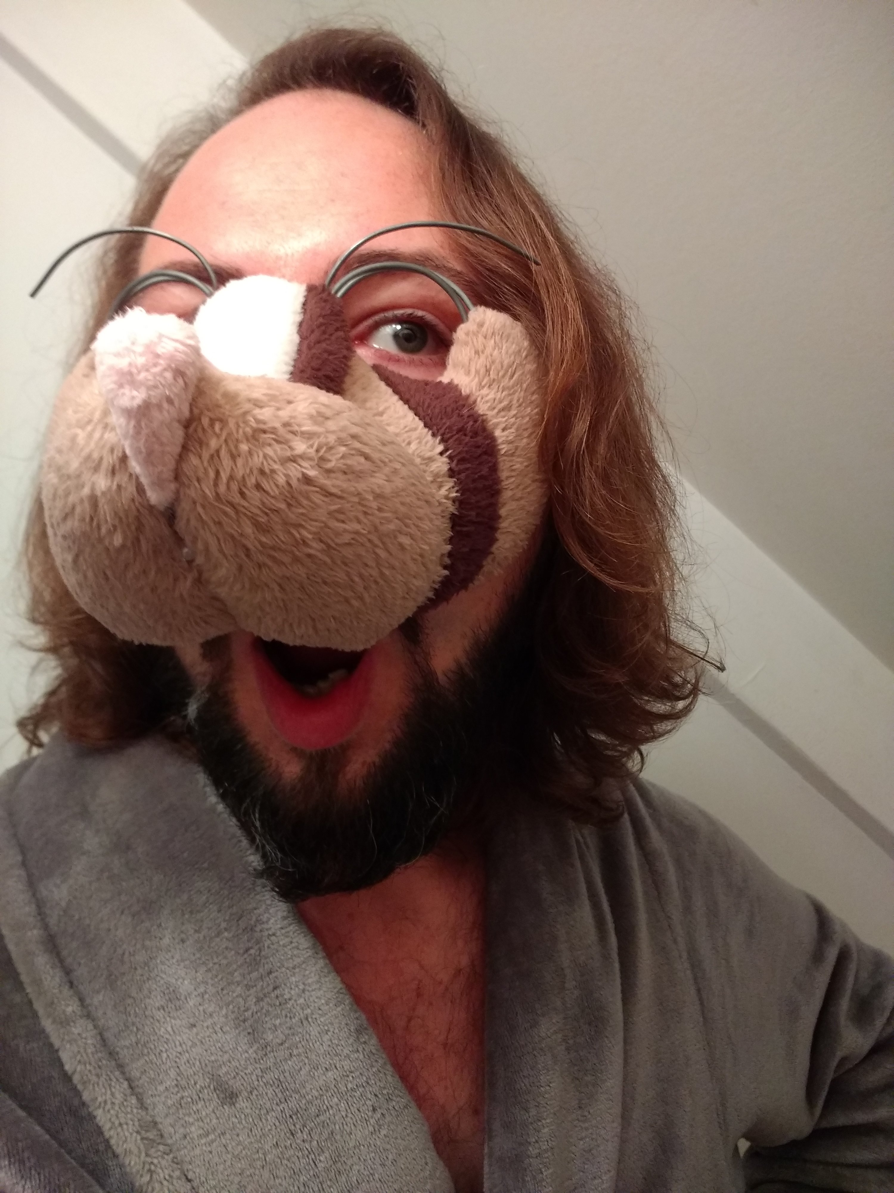

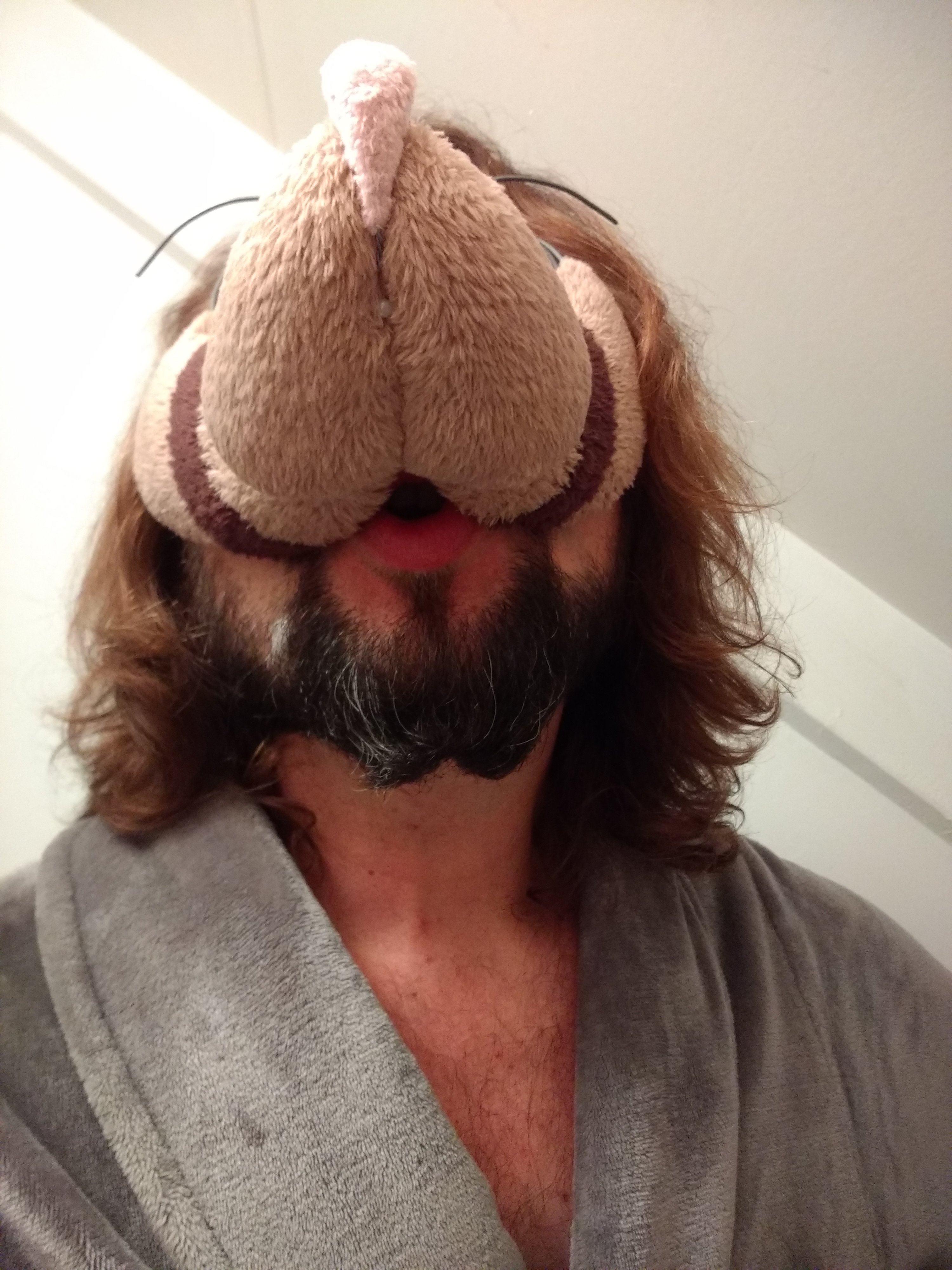

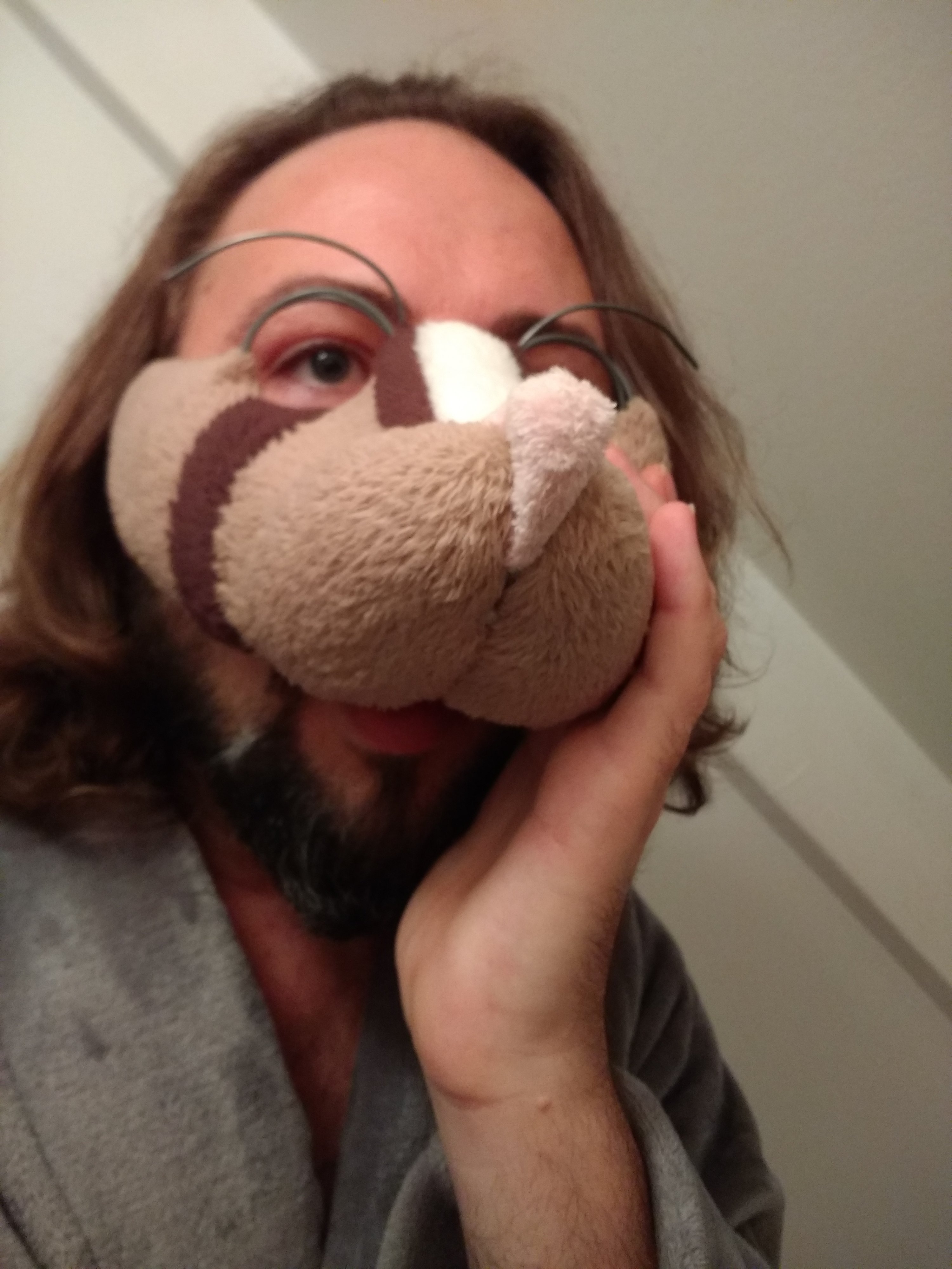

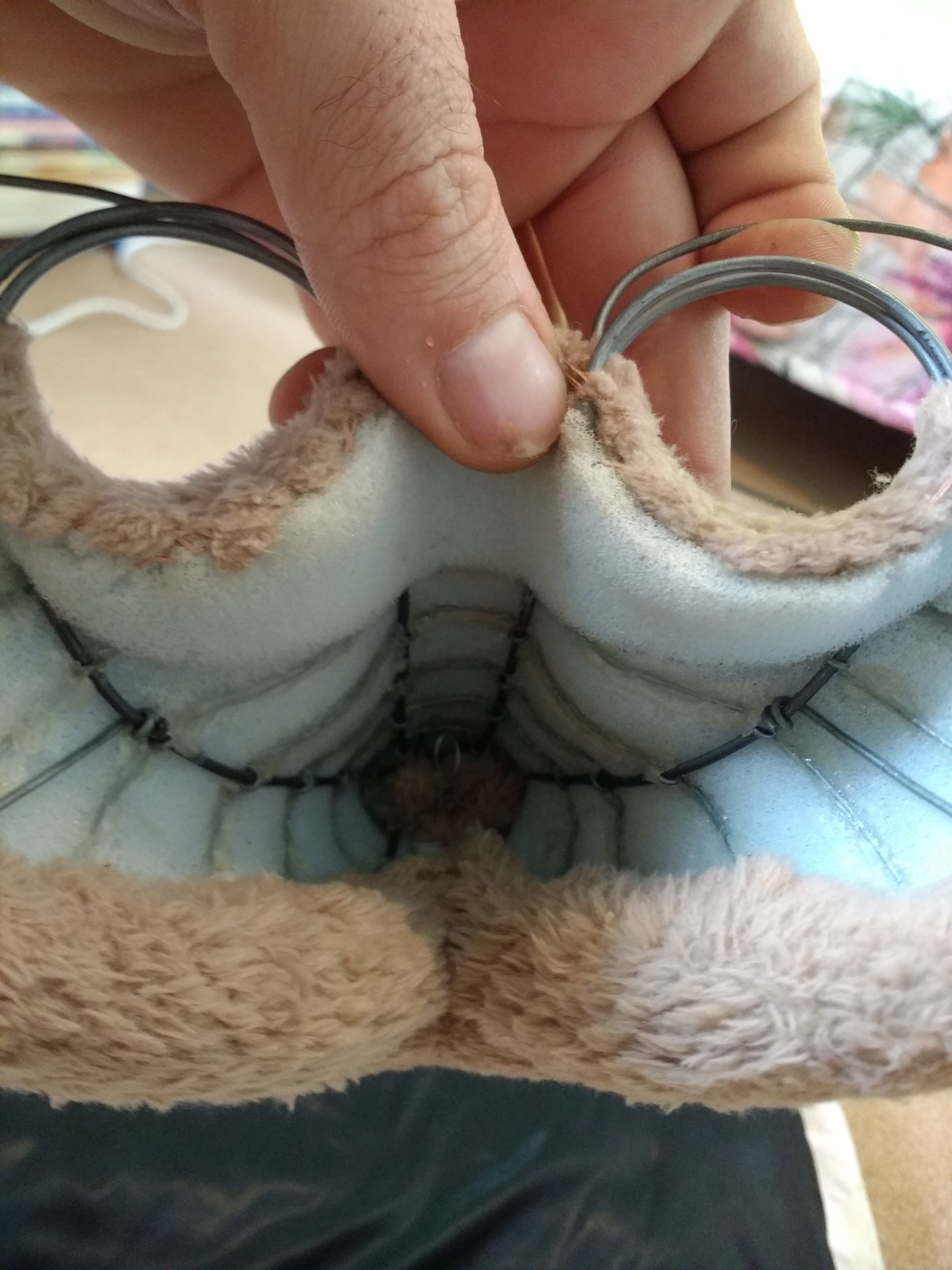

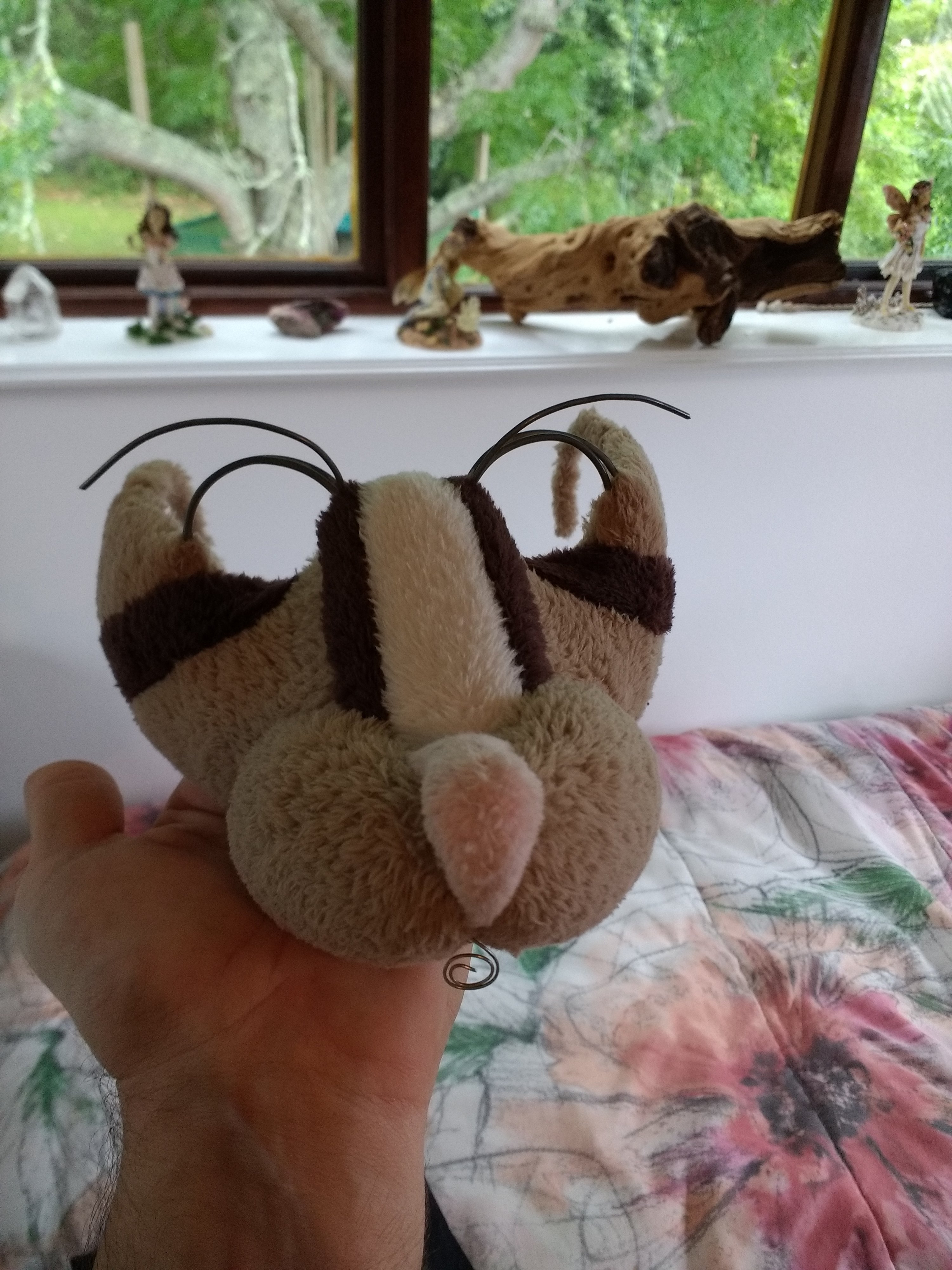

I know you can buy portable ones, but I need something as discrete and lightweight as possible... So I think I will have to make one from scratch.
What I am wanting to do is fit it into the snout of a mask I am making... Have a little mic positioned near my mouth, and have have it output to some speakers that I will build into some fake ears or something like that.
I would like to be able to program how the voice is changed with python (or whatever), so I need to be able to plug it into a computer, or it needs to be able to receive a microSD, or something like that.
Obviously as low power as possible, I would like to power the speakers separately, wired to a battery pack on my chest or elsewhere. So I would need small batteries in the snout.... Or alternatives?
Any and all ideas welcome... From general ideas, to python code, to specific circuitry and components required...
I'm all ears.
Included are a few pictures of the mask.
