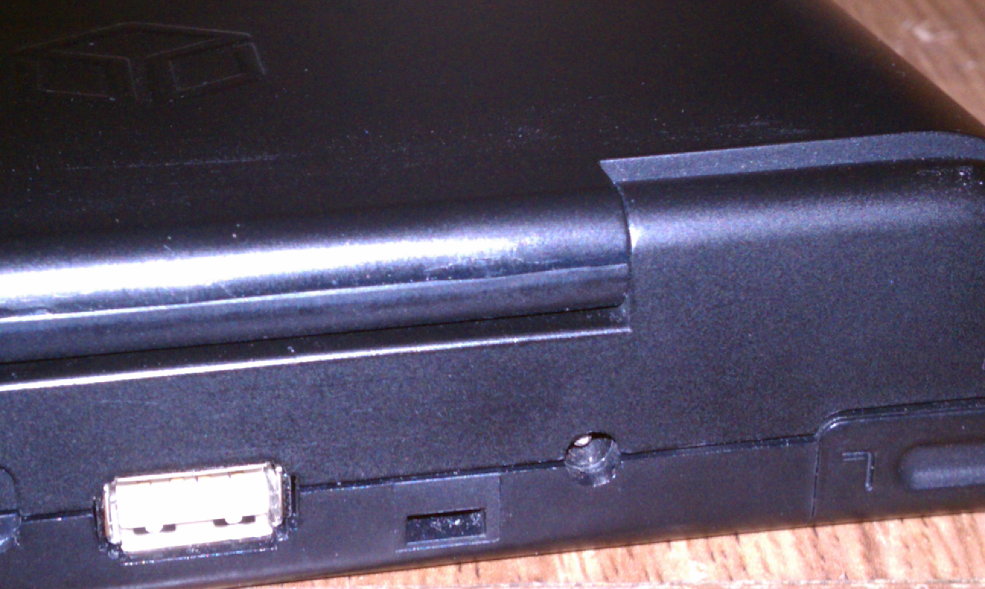

However, I did take a snapshot once it was finished.

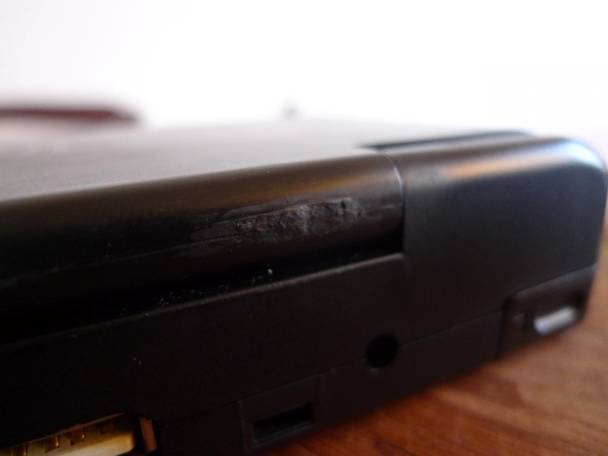

This is how mine looked after I'd finished the above process. Below is a close-up;
Mine is now curing. Since the Sugru is slightly flexible, with any luck this should prevent the problem from recurring, even if the strut/stud/clip inside does happen to push against it a bit. At least now I know exactly what to do if the other two hinge-welts break apart like this one did, and it's certainly better than having to send it back!

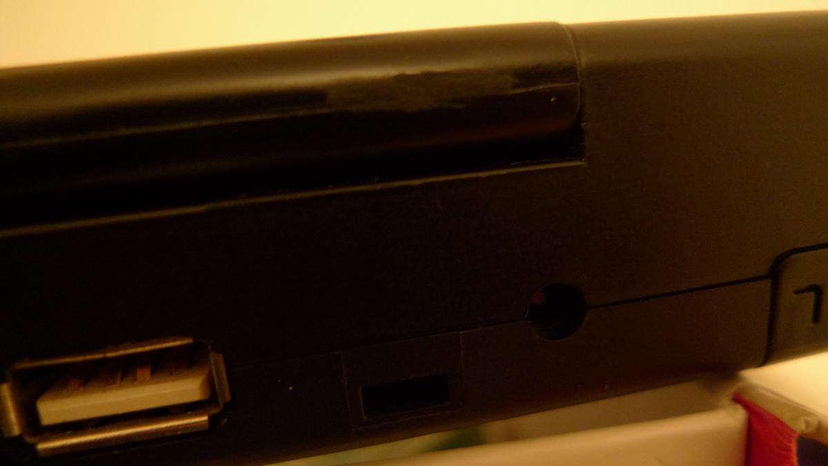

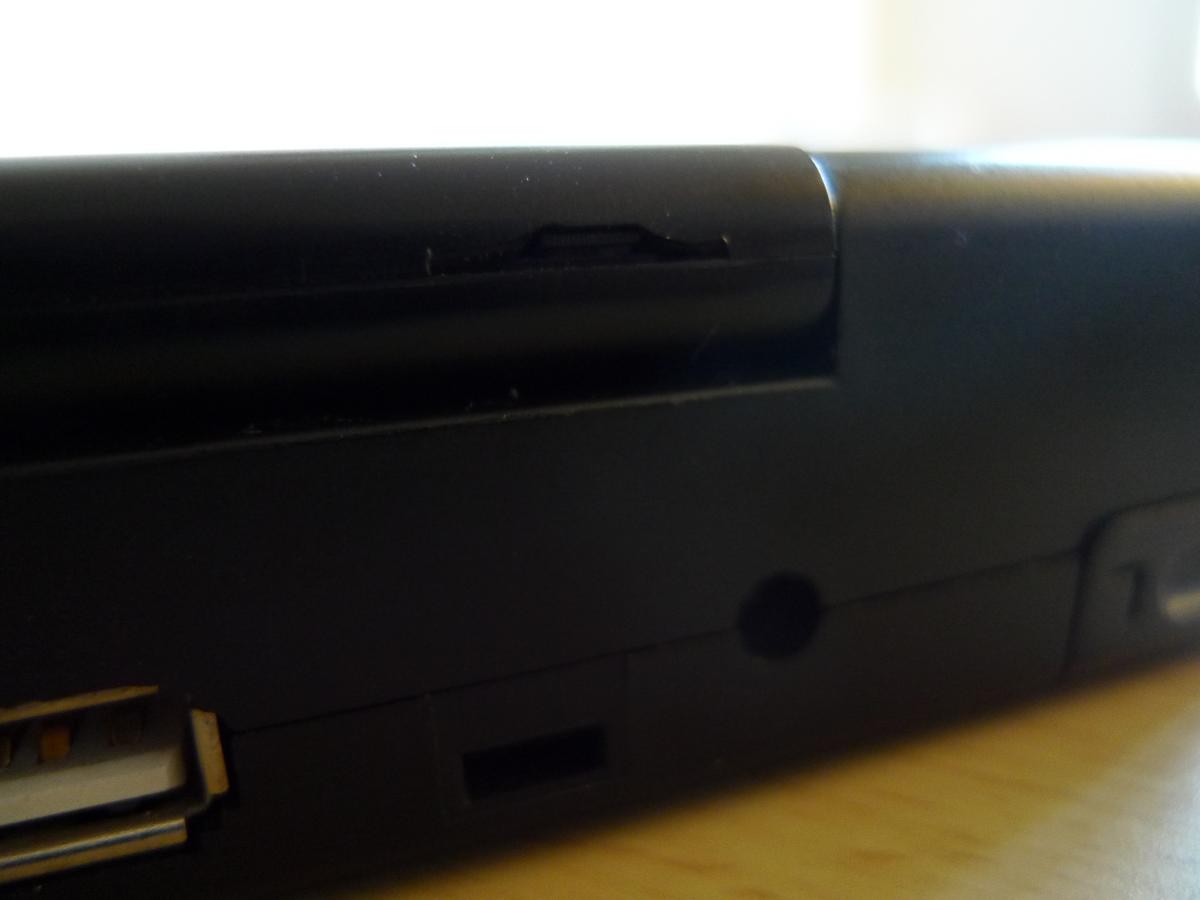

here are some pics of using milliput to cover hole in hinge; the trick with milliput is to make sure you have mixed the two parts thoroughly before use. at least 5mins is recommended, i failed to do that and the mixture had some smears in when you scratch at the filling, i temporaliy covered this with some black crayon!
before pic:
curing:
after 5 days and a bit of black crayon:
Oh, wow, that's a nice finish!
How do you think it will hold up over time? What I quite like about Sugru is that it's flexible, so it can handle minor flexing of the case (such as if it's in a bag or pocket, where I assume this will occur) nicely.
not sure since i did not mixit up properly but no worries since i can just mix some more if i need to redo it. by all accounts if mixed properly it should last a while.
If it lasts, it sounds like awesome stuff. Thanks for posting the pictures, too! :D
