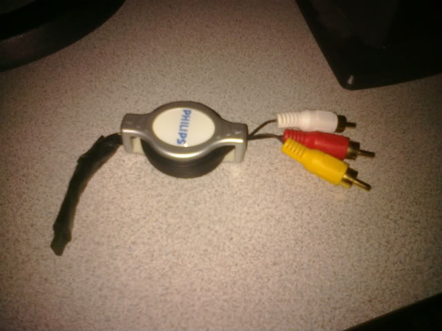

How Do I Activate The Video Out?
canguy247
Apr 21, 2008
79
I am just wondering if the scripts are available yet.
Canguy

The last that I recall being said was that S-Video but not composite out were working? (I see your cable has all phono heads)
Canguy said:
There is a capacitor buried in there. I use svideo out and then convert it.
I've used this method myself, works fine (not with pandora though, other s-video source)
