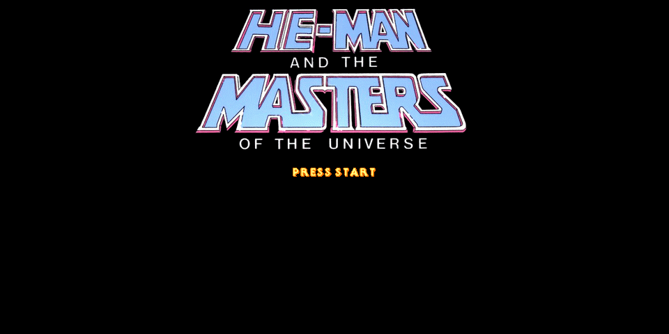

He-Man game
Well, it runs using openbor, which we already have on the Pandora.
So... throw datafiles on it and it should work ;)
Please do it ... I want it on my Pandora.
Please do the datafile throwing wizardry milkshake, "You Have Tha POWAAAH!"
I took the d/l to attempt get it running on my Mac, but wouldn't play it much on that, I'd much prefer it on Pandora
Well I could have a try, our openbor is quite old so hopefully it will work, if not I'll have to ask someone to compile the latest version.
The current Pandora version is OpenBOR v3.0 Build 3742.
The up to date one is OpenBOR v3.0 Build 3979.
So, yep, got differences.

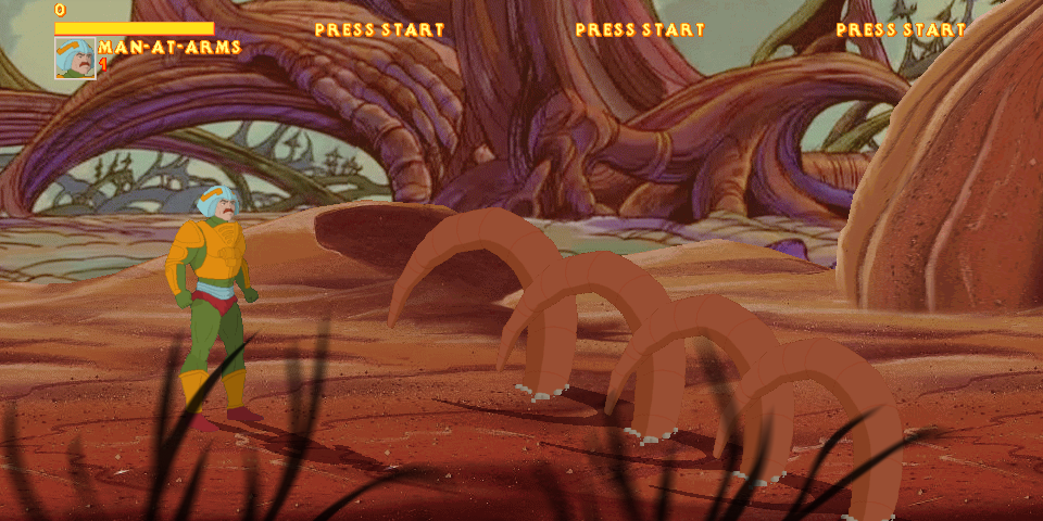

I just tried and when it loads OpenBOR crashes and goes back to the desktop :( I believe we need an updated version
sorry guys I tried all night to get it to work but failed, I even compiled a more up to date version of openbor on my old xcompiler mcobit helped me with but it didn't load any games.
I got further by repacking the he-man.pak file using the inbuild tools which turns all filenames to lower case.
I could load the game through to the menu's on my pc (ubuntu) but it crashed when loading a level.
maybe @mcobit or @ptitSeb could help here :D ,
I do know that before I repacked the he-man.pak I adjusted the data/video.txt to a valid mode because I was getting this before:
Invalid video mode: 960 in 'data/video.txt', supported modes:
0 - 320x240
1 - 480x272
2 - 640x480
3 - 720x480
4 - 800x480
5 - 800x600
6 - 960x540
Inside the data/video.txt the it was video 960xsomething else so I changed it to video 4 which got passed that bit
