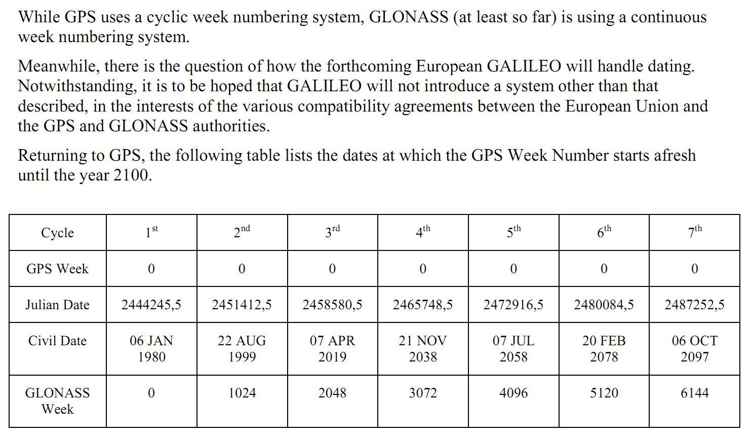

    Not the first time it happened (see table below, notes from a lecture by my former professor Mr. George Preiss), although I don't know what happened to the functionality of any hardware (well, non-military hardware) during the 1st and 2nd "unwraps" of the week number.
