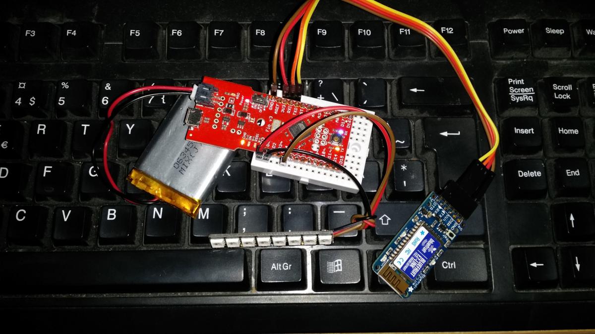

Here comes some photos...
This is how huge the thing is:
Acceptable for a proof of concept, then again not for much else.

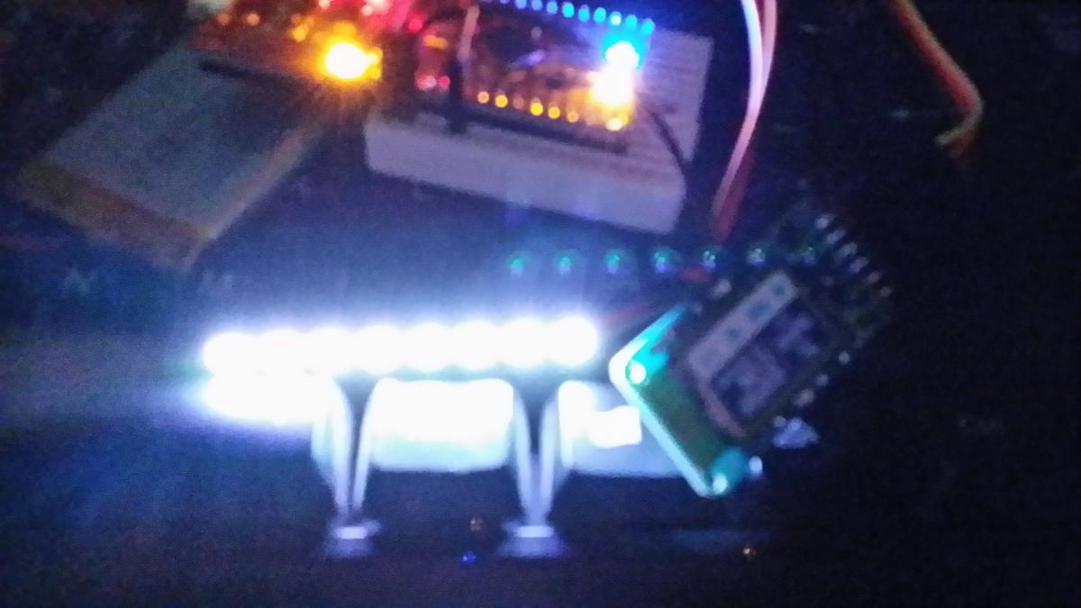

Here I am trying to capture the LEDs:
Doesn't really say much more than how bright these things are even though I caught it near the end of the fade. When I used the circular (currently misplaced) one as a tachometer, about 5% brightness was what you could actually use for viewing. They're not the brightest LEDs out there, but they will still give you a headache at full brightness.

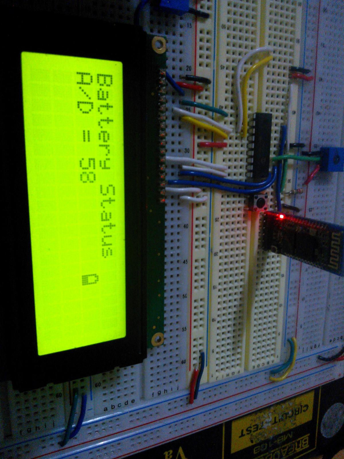

There's so much more which could be done! I'm an electrical engineer and getting a graphic touch-screen to work with a bluetooth peripheral is quite easy:
You build a Menu with important notifications (Battery Status, USB Port status, Wifi network, bluetooth status, and many more)
We only need access to the bluetooth stack of the ARM mcu, and send them the info's to a bluetooth chip (many on the market are cheap and easy to use).
Quick picture with my cellphone battery percentage status, using a PIC and a HC-05 bluetooth module (the setup is quite BIG, but can certainly be reduced to the screen size only).
