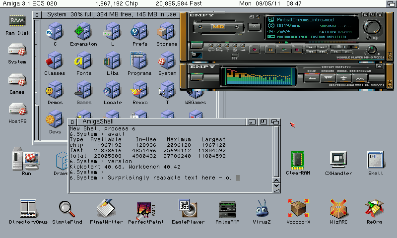

The screenshot of Classic Workbench at 800x480 above looks amazing so I was really looking forward to this.
At first tried Slam Tilt, Banshee and Pinball Fantasies AGA. They don't work (so this EUAE version doesn't emulate AGA). You can see Pinball Fantasies' scorebar, but the table is black.
Then tried Lionheart which has gfx problems in UAE4All. And: same here. Same gfx errors.
Then tried Jimmy White's Whirlwind Snooker which freezes in UAE4All. With this E-UAE port: freezes at the exact same point (when trying to enter a game).
Suggestion: port a more recent version of E-UAE.
