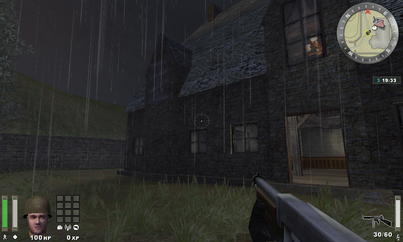

Here is ET: Legacy, the open project aimed to improve Wolfenstein: Enemy Territory.
Note that the data files are not included. But there are free and can be obtained on the net (here for example http://www.etlegacy.com/) if you don't have them already and the "etmain" folder be putted in apddata/etlegacy (it's the "etmain" folder, weighting 250Mo, not the "legacy" folder that is already included in the PND).
Also, to play online, you will need an etkey (to be put iside the etmain folder). You can generate your own key here: http://etkey.org/
/!\ If you want to host a game, you will need a Swapfile. 512Mo RAM user should be ok to Join games without Swapfile /!\
/!\ CC user (256Mo models) will need a Swapfile for this games /!\
Nubs are configurable (see left_nub and right_nub inside appdata/etlegacy/home) and are configured to Left nub=Joystick (move) and Right nub = Mouse (look) by default.
There is a default key map, with keys similar to other FPS release.
