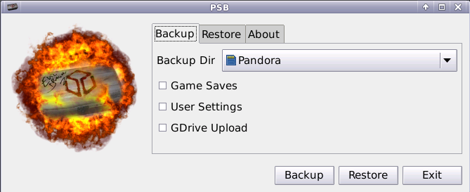

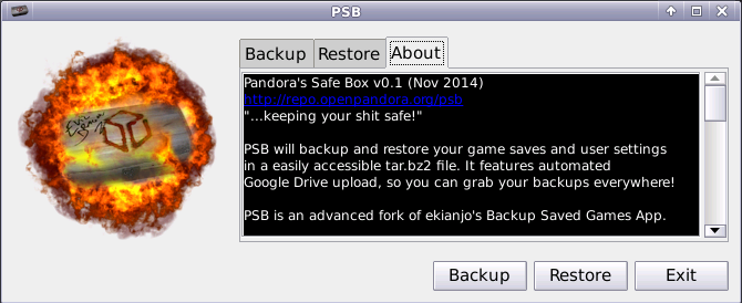

I'm currently working on this advanced fork of ekianjos BGS.
Right now it looks like this:
backup, restore, gdrive upload... all works well.
now i figured: why not backup user specific settings as well?
after a full reflash all your settings can be restored with just one click.
PSB will iterate over a customizable config file with files and folders to backup.
which settings files/folders would you guys/girls want to get backed up by default?
ideas what kind of features you would want in a pandora specific backup app?
any input is very welcome!
