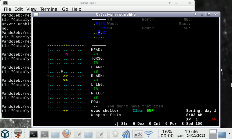

I have it running on the pandora... Can do a PND if no one else do it.. I try to post a screenshot of the menu screen
*EDIT*
Here, a screenshot of the the gameplay: previews1.png
With a bigger font (size 13). If I choose bigger, rxvt choose to not listen to geometry parameter, and cataclysm wont start if it doesn't have his 25 lines...
Ahh, font size. If I can override that, I can get a fullscreen version running. Works fine now :)
Just need to find out where the terminal stores its settings.
D.
for rxvt, you can overide the font with -fn "xft:fontname" parameter. But for standard Terminal, I have no ideas.
