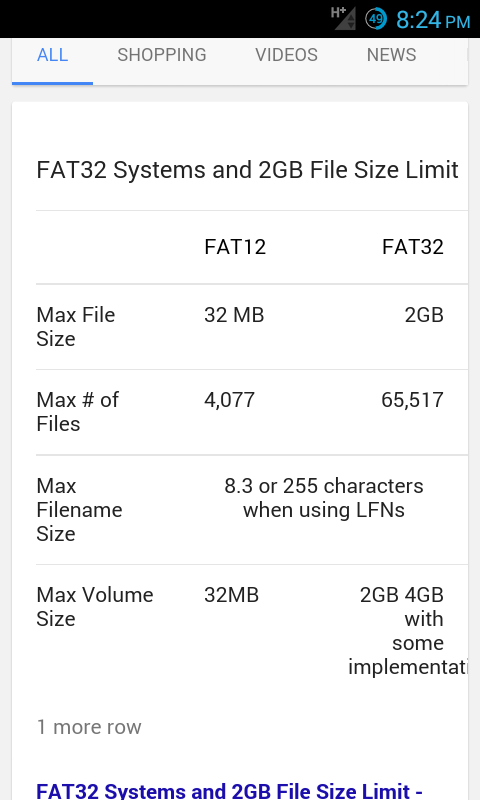

I haven't been able to copy 2+ GB files to my FAT32 SD card, and this seems to support a 2GB file limit... Dunno about EXT4s issue though.

@Swordfish II, hmm honestly have no issues copying a 2GB to 4GB file on my SD cards Fat32 or EXT4 once I have it downloaded, the issue I have is specifically with downloading it from PNDManager.
